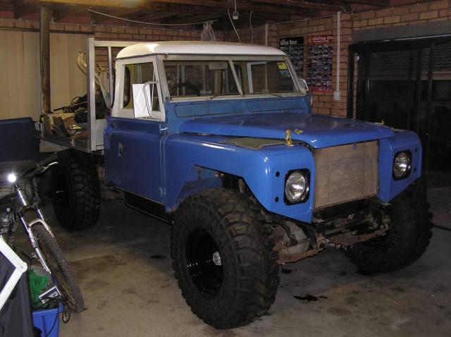

The SOA on stripped down springs will give 4", so you would expect about 5" lift by doing this. I did mine straight onto Toyota Hilux (Minitruck) axles.
The V8/LT95 is an interesting and really difficult fit, and in my opinion doesn't work on a SOA SWB. If you keep everything behind the original IIa facia the it leaves almost no room for a rear propshaft. To make this work I ended up linking and coiling the rear suspension and taking it out to 100" WB and then making a Hilux DC front shaft fit the rear. Even then the angles on the shaft are severe before allowing the suspension to change from normal ride height.
Its a little obscured in this pic, but the handbrake ends under the Xmember and you can see how close the rear diff pinion sits. At 88" there is no way a rear propshaft will work - but this has the engine gearbox sitting so that it will fit behind the original facia at the front - all 90's etc have the motor sitting a bit forward of this.
In this pic the axle is moved back to give a 100" WB and it will work, but I'm guessing you don't want a 100" WB
Doing this produces a really big truck for its wheelbase in my opinion, and it was scrapped because of rust, but when I rebuilt I didn't do it the same so that it would be more usable offroad.
88" SOA.
100" SOA/Coiled.
109" but not complete.
