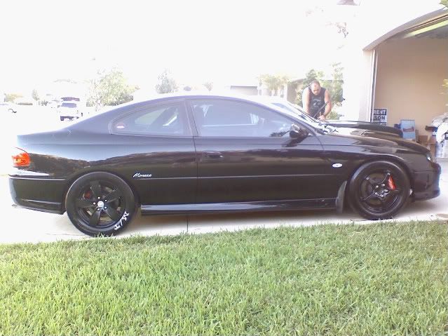

Here is pics of the goat. I did the Monaro conversion on her so it is a little different then most GTOs.
A pic in street setup with my brothers pristine Z28:
Here it is in race setup: (don't mind the scary dude in the pic. That's my detailer cleaning the Jag.)

snazzy!
