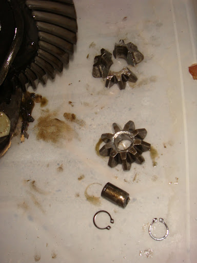

Spot on, gents. Snapped third member (rear diff) locking pin, taking with it one of the small planetary gears (spider gears).
Pic - below a little piece of the locking pin and the two planetary gears
the broken locking pin in the centre
My options:
1. try and find a locking pin and spider gear, and install them myself
2. replace entire part with re-built unit
3. upgrade (True Trac LSD unit?)
Any advice appreciated.
