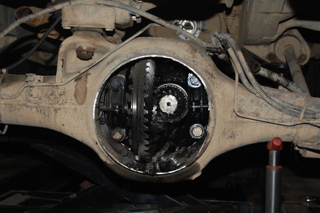

Don't put 35s on your truck unless you're ready to do something like this...
Or you'll end up with this...

Alright so 33s will be the best for me then lol
