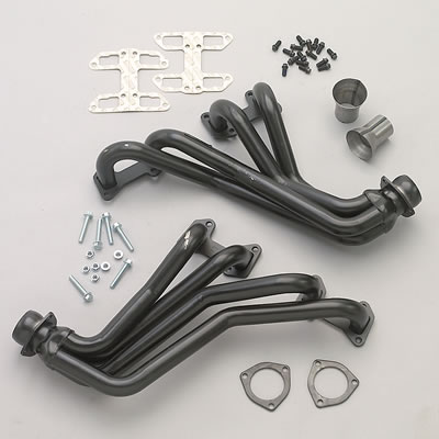

First, the website says that those photos are for illustration only. The website also made no mention of their exhaust systems being made of stainless steel. Additionally, I saw no mention of headers as part of the system. Finally, due to it's dimensions, an exhaust system from the UK would cost more to ship than to purchase.
If you want a premium stainless system there are several reputable manufacturers available here in the US (NRP, Borla, ect.). I don't think you need to look to the UK for an exhaust. Frankly, I'd find a local hot rod shop with an excellent reputation and ask them for suggestions regarding an exhaust. I am lucky that I have a friend who specializes in stainless exhausts (he's currently fabricating a system for a 1937 Lincoln Zephyr with a V-12) and I'll bet dollars to donuts that what he can fabricate is every bit as good if not better than anything you can buy off the shelf.

Summit Racing has headers for a 3.5 for $135. Wouldnt these work on a 4.2 also?

Sure, you could extrude hone the runners- install the DAP/Mallory ignition- headers, cam, etc etc. So you'd take a small V8 and make it slightly more powerful, emissions failures, cooling problems most likely.
I've got a 3.5 with SU carbs and 95 disco distributor in it and a 4 speed with overdrive- it gets better fuel economy than my 04 Disco. Installing a Mallory in my 95 Disco improved it only slightly, but replacing an old distributor with a new one often will give an improvement. The main benefit there is the Mallory is more durable and easier to get parts for.
I know a lot of guys who built up Rover V8's for MG's and it CAN be done but it seems to have much less return on the investment than just about any other engine ever made. You could easily drop $10K on one of these Rover V8's and still only have a half decent engine.
