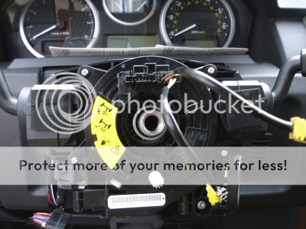

New clockspring (Note the 12 volt connector for the heated wheel at the 12 o'clock position)
[/IMG]

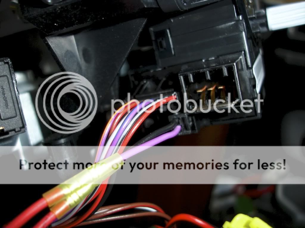

12 volt source connected into the side port of the new clockspring

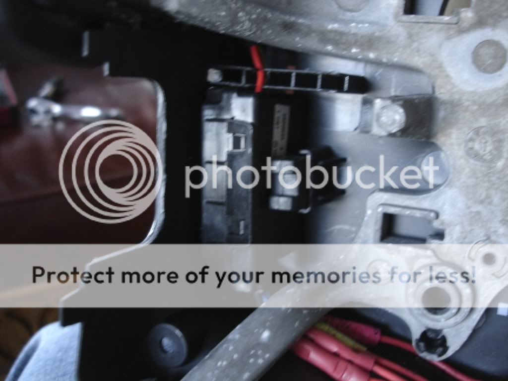

Heated wheel ECU which controls heating for the wheel

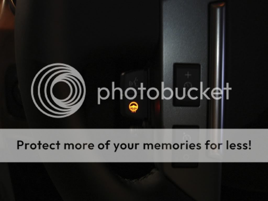

All warm and toasty! NOTE the illuminated "on" indicator on the switch
