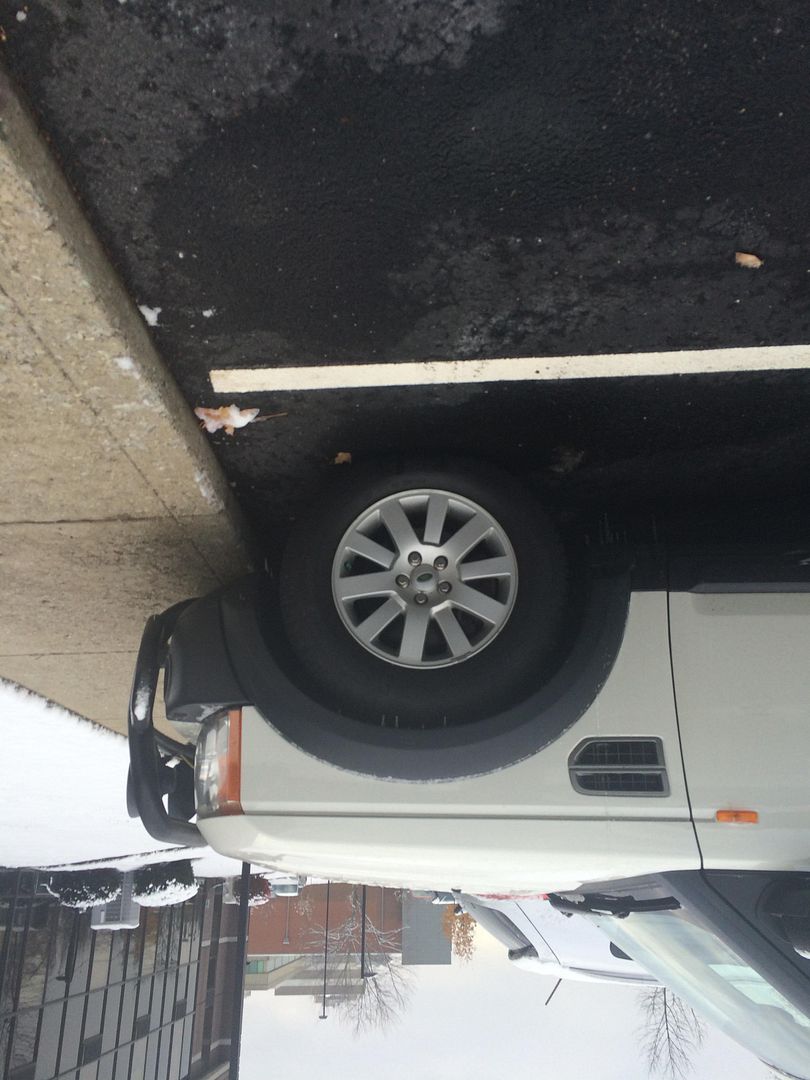

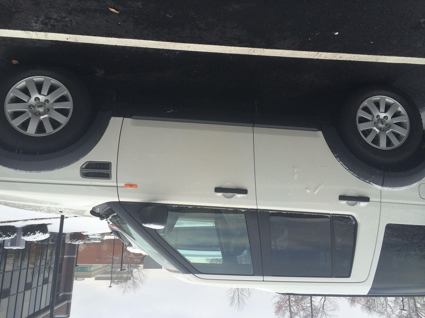

I have an 06 LR3 with about 120K miles. Noticed Suspension settling overnight to acces height. My Independent Mchanic found a leak in R Front airbag and a very small leak in L Frnt. Went ahead and had both replaced. Next morning the front was lowered but rear was not. Took it back and they found a small leak at front of Compressor. Replaced that yesterday. Came out this morning and front was lowered again. No fault lights ever came on during any of this and no codes stored. Just knew I had had a leak somewehere.
Is this really an issue or any ideas where else to look for leak or cause of front lowering?

I just noticed my car started lowering now that it is below freezing. Maybe I have a leak too that cold is exposing more, as well, air volume shrinks when it gets colder.
