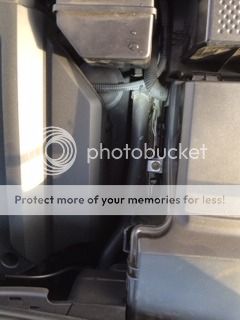

Let the repairs begin!! LOL I just bought our 2008 LR3 HSE a month ago. It is very clean with 70-ish K miles on it. My wife took the kids to school a few blocks away this morning, and when she got back said there was a slight burning smell under the hood. I popped the hood and saw slight smoke as it looked like from the left side of the engine. It stopped immediately and I could not locate the source. It smells like burning electrical. not very strong but it was there. I looked everywhere with no traces of anything visually burnt. I drove it around for 30 mins and could not recreate the smell or smoke. I saw the slight smoke above the alternator area it seems. Any thoughts?

I even poured some water on that silver heat shield to the left thinking maybe she went thru some water... I don't know. But I do still smell a slight elect burning smell? could some water have hit the windings or something on the alternator below?
Just a bit ago I got a message on the radio display that stated, "Low power Mode" with a pic of a battery when I tried to turn up the radio volume. It also would not let the volume go any higher. Sounds like my burning smell is possibly my alternator going out?
