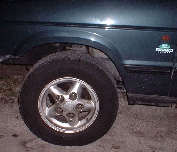

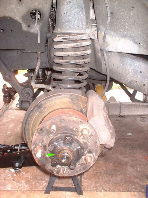

We begin as any repair to the drivetrain would, by removing the tire of the specific side that will be worked on. That in itself, as we all know, can take a single person up to 10 minutes to manually remove if the lugs were previously placed using an impact gun. You then want to pry the rubber cap from the flange, remove the cir clip and shim that is located at the very tip of the stub axle...
One could, and should remove the caliper first after removing the tires, but I was so excited I wanted to gut that thing quickly. To remove the caliper you will need a 13mm 12 point socket/wrench Because you don't have much space to turn a wrench, a socket with an extension would definitely get the job done quickly)...

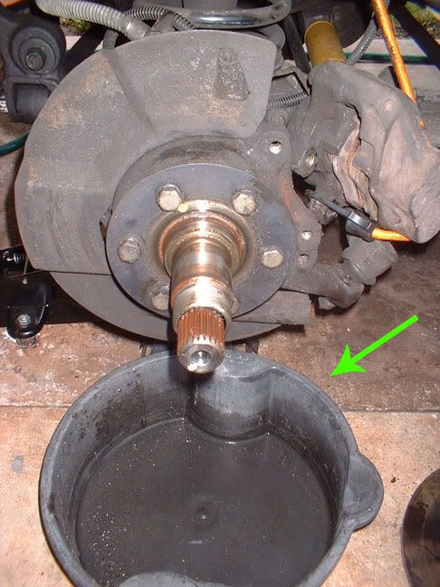

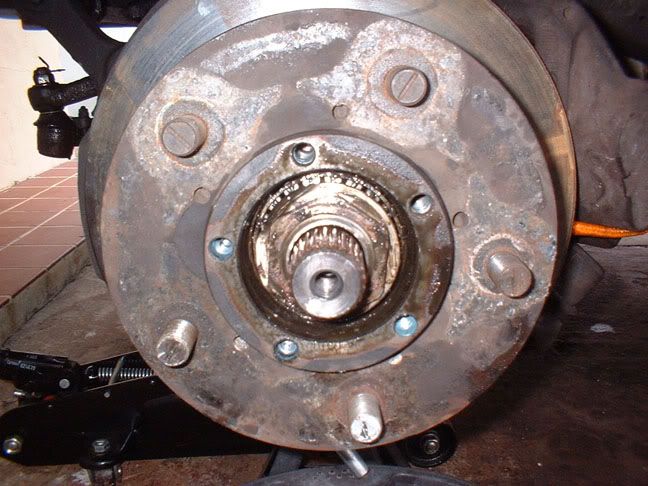

Now you can remove the flange. You'll need the 2&1/16th socket to remove the lock-nuts (referred to as a shim in the manual). In my case, both of the lock-nuts were DANGEROUSLY loose! So loose, I was able to remove them with my hand! You'll also need to pull back/up the flaps(2) on the middle shim that have been folded down...

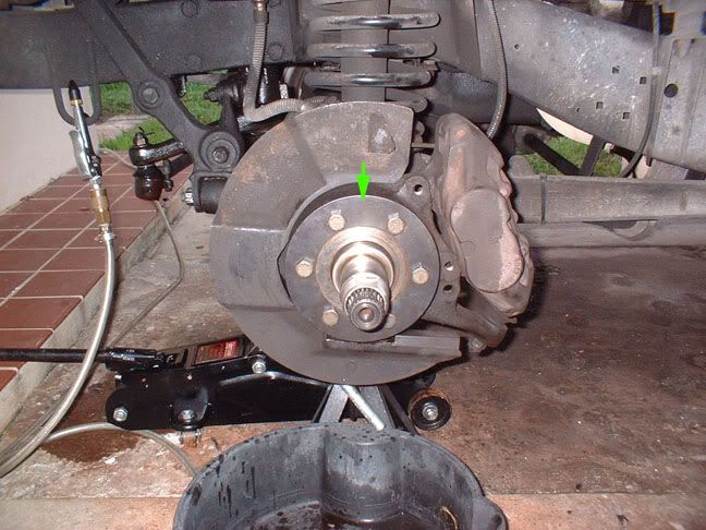

After removing the shims and lock-nuts, give the hub/rotor a little tug and the outer bearing will come loose. After pulling the bearing off, you can now pull on the hub/rotor assembly and it will come off freely. Now you're almost ready to pull out the CV. But first, make sure that you place a pan of some sort under the swivel if you haven't already drained it. Once the first bolt is removed, the oil will drain out of it.
NOTE: Oil would have been used on pre-97 Discoveries. If you don't have a drain plug on the knuckle, you're swivel is, or should be filled with grease.

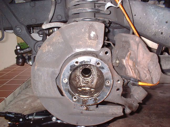

After you've removed all six bolts, and the mud guard, you are now ready to pull out the stub axle, cv, and the axle. ...

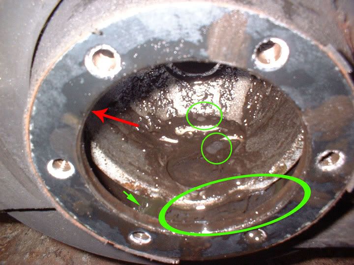

When I was removing the bolts, I noticed only a few drops of oil come out. When I finally removed the CV, I found the swivel to be completely dried out, relatively speaking. I also noticed the oil that was left was contaminated by water (shown circled), and a coolant-looking liquid (pointed out by the small arrow).
Make sure that the oil seal on the knuckle is removed (pointed out by the red arrow)...

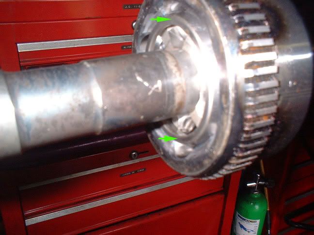

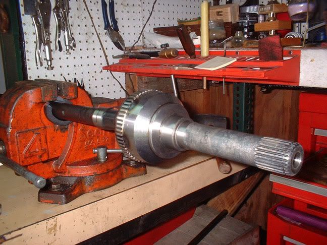

Place the axle and CV on a soft grip vise. If you don't have one, I used AC insulation tubes and wrapped it around the axle to put it in my vise. If you don't mind smacking your already damaged CV, you can use a normal hammer, but if you're going to have that CV rebuilt, then use a rubber mallet to hit the edges of the race (pointed out by the arrows) to take it off the axle...

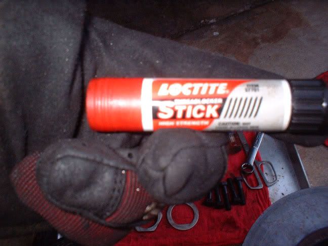

Now head back to the truck and slide that baby in there. Don't forget to place your seal on the stub axle and PLEASE don't forget to put your mud guard on (I did, after I had torqued the bolts to spec). You'll need Loctite 270 & 520. I went looking for those but only found color designations, blue and red. The stub axle bolts use Red, which is the High strength compound. Blue is used on all the other bolts, including the Caliper bolts...
