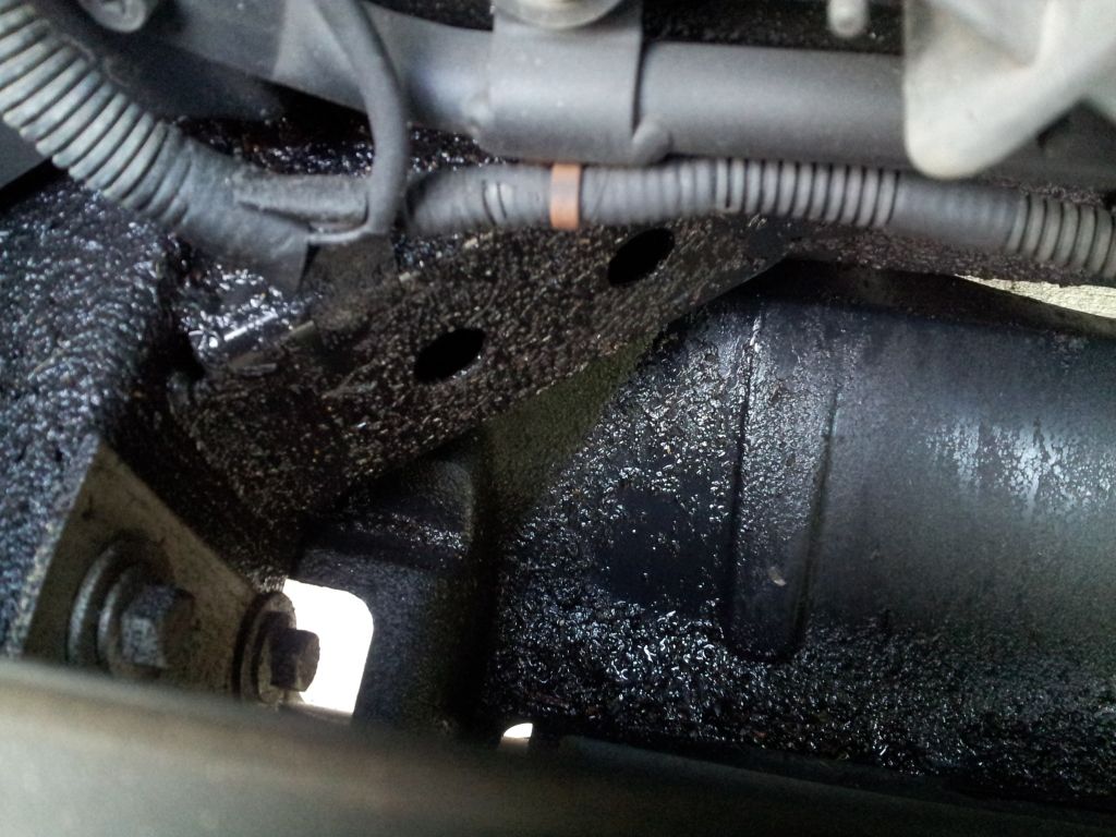

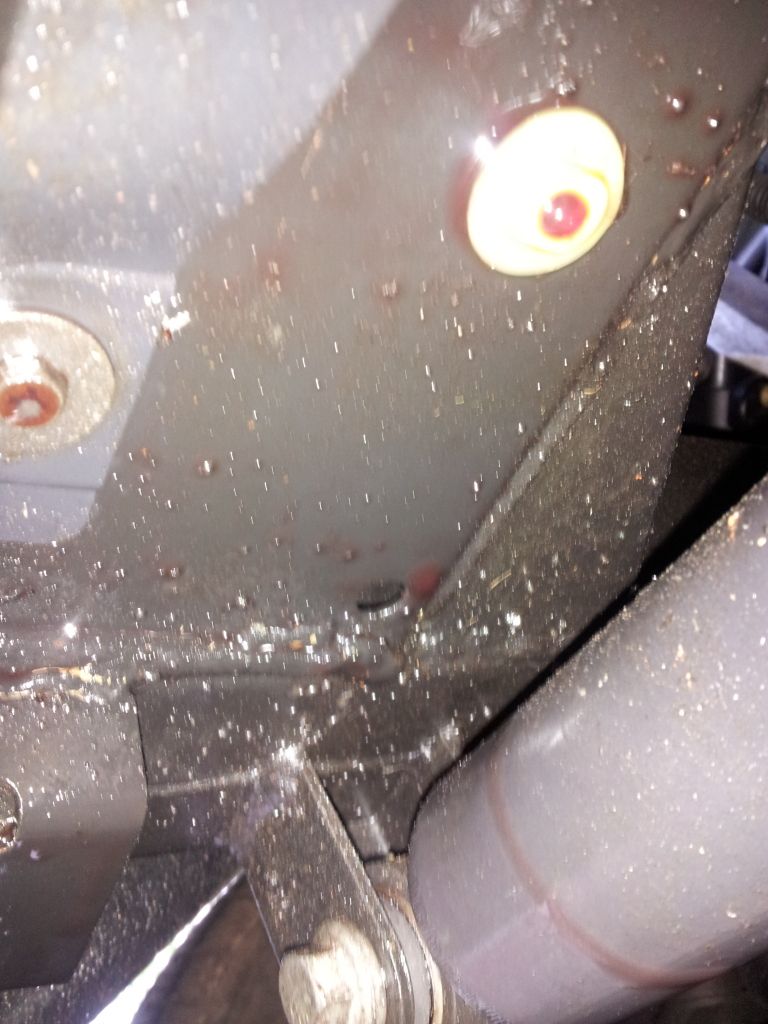

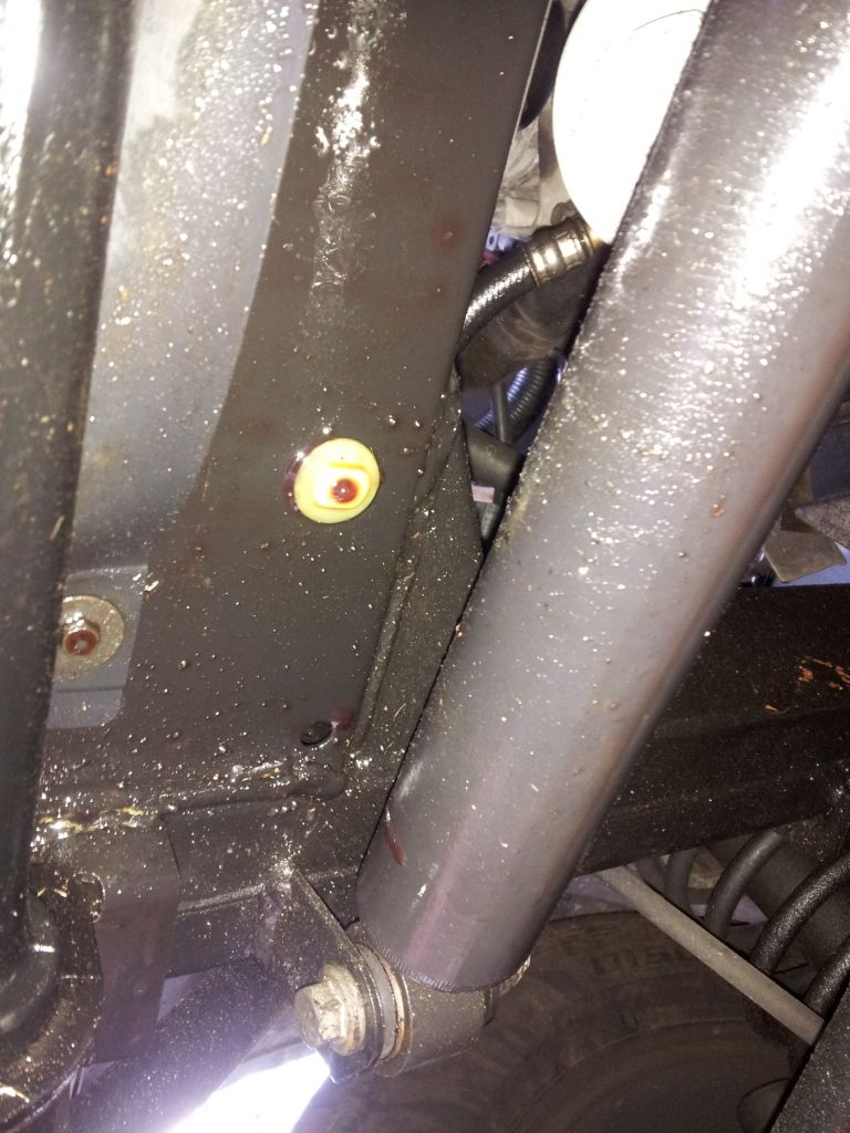

So I stopped driving it for a few days and took a few minutes, pulled the grill, radiator top cover and ran it up on my ramps and this is what I saw:
Behind the grill on the passenger side
Underneath looking toward passenger tire:
Close up:
So would you agree it has to do with the Tranny cooler? Power steering doesn't appear to be leaking. It was a little low (just below the minimum line) so I filled w/ Lucas PS Sealer. My leal still appears to be just as bad though and the PS hasn't lost anymore fluid.
Thoughts?
Definitely trans fluid, but lines vs cooler you can really tell from the pictures. If you determine it is just the cooler, just know that you might end up needing lines as well, see more then a few that were seized on the cooler that could not be removed without damage to the fitting.
