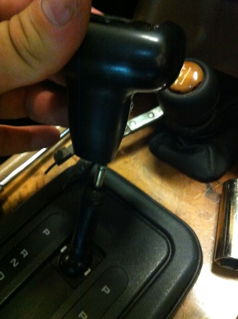

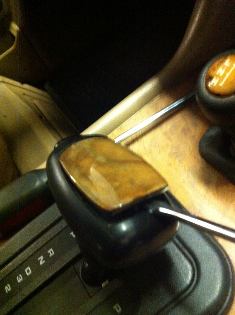

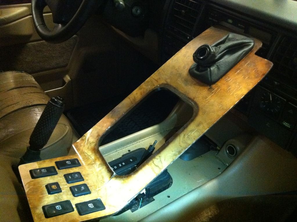

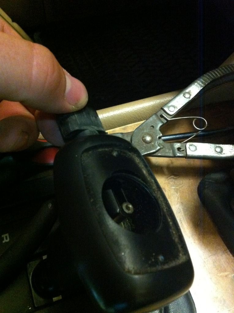

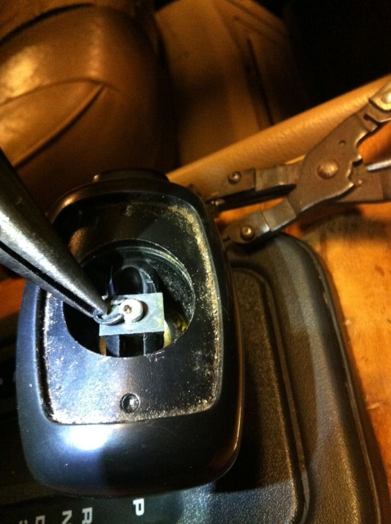

Hey guys mine did in fact just bump out and up and slide off. I love those hookie things as opposed to disassembling my doors. The center console did require some dis-assembly however so I will post pictures here and the steps to remove it for the good of future generations lol. These were shot in a garage with a phone so forgive the awful quality. Also I am completely new to working on anything so I'm sorry if I refer to a technically named piece as the round or square dohickey
Step 1: Buy Beer
Step 2: Drink a Beer
Step 3: Use flat head screw driver or your small delicate prying tool of choice to GENTLY remove the top of the shifter. Pry at whichever space is most accessible but land rover for some reason recommends the front right.
Step 4: You will now see the inside of the shift knob looking like below. Remove the clip as depicted and FOR THE LOVE OF GOD DONT LOSE IT!
Step 5: Remove the square piece with the rounded bottom over the shift button slide. like below then slide out the slide. Leave the spring on the other side of the slide in there is no need to remove it.

Step 7: Gently pry up the surrounding trim piece with a screw driver like so
Step 8: Unscrew the low range shift knob and gently pull the wood back. DONT PULL IT UP AND TOTALLY OFF BECAUSE ALL OF YOUR SWITCHES ARE STILL ATTACHED!

Step 10: Remove the plugs from the back of the switches. You wont just pull they have little tabs to push down and then pull. I recommend either doing them on at a time and reconnecting them afterwards before going on to the next plug or labeling them somehow to keep them organized. Next simply give the switch a gentle tug and it will pop out the front. Note: the heated seat switches have a metal tab on the one side of them. It may be difficult to pull out and put the switch back in but do it carefully. If you dont this tab will fly off and in my case be lost into the abyss.
Step 11: Remove the four metal tabs on the bottom of the low range shift knob. You will want to be careful not to snap these and especially careful to not let them fly away. These things like to really pop off.
Step 12: Do whatever it is you needed to remove the wood for because you're done!
