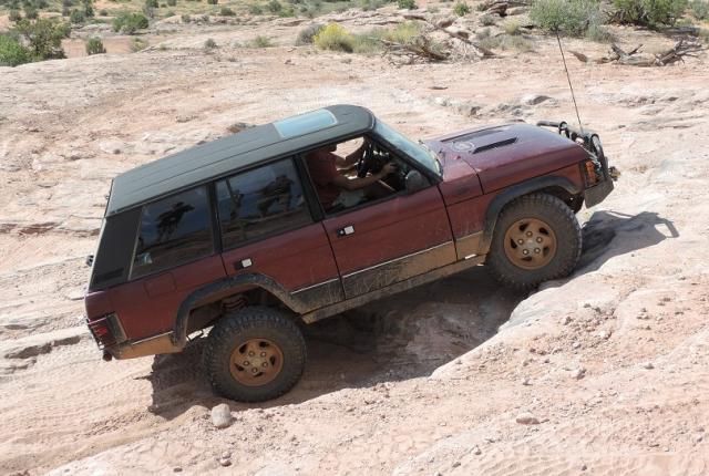

This truck has only a 2" spring lift and he's got 33x12.5x15 Cooper ATs. 15" triangle steelies. Looks good IMO. The right stance.
